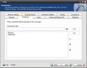

  7. Well, I've fixed everything and used your suggestion for the .NET Framework RunOnce. Unfortunately, everything I've re-done seemed to have no effect on the Theme issue (it, once again, has shown up as Classic with no others showing up in Display properties). The .NET install also froze for a while, but did end up finishing. The themes nonsense is starting to get aggravating to say the least.

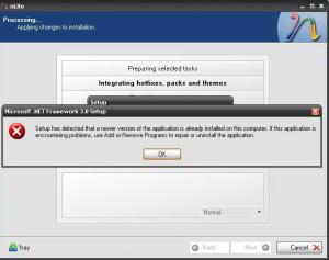

  10. Here's the links to the .Net Framework installers: .Net Framework 2.0 http://www.microsoft.com/downloads/details...dd-aab15c5e04f5 .Net Framework 3.0 http://www.microsoft.com/downloads/details...f5-25634c3bf043 .Net Framework 3.5 http://www.microsoft.com/downloads/details...31-508d977d32a6 Here is the Last Session and screenshots: Last_Session.ini

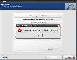

  11. I tried using the installation packs for the .NET Framework versions from the MS DL Center website (I also used the commands you suggested in the RunOnce tab) and it didn't work, 5-8 errors popped up and none of them installed. Is there something I was missing? Thanks mara, but I'm not registering to a forum just to download it, heh. Cheers

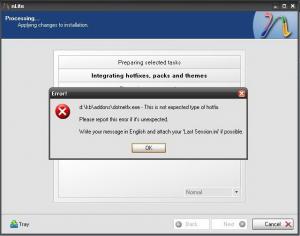

  21. Yes, I don't know what's up. I enabled the Uxtheme option under the Patches tab and put every single update and hotfix in order, but I tried the new ISO I made last night in VMWare and the Themes are still missing, I mean all the themes are missing except Win98 Classic. Also, what's wrong with that all in one .NET addon? Something wrong with it I need to know about? Cheers.
  22. That's causing the problems with all the Themes being missing? I downloaded this - DotNetFx_All_In_1_Addon_v2.4.7z - from somewhere that said it would install perfectly in nLite if it was added to the hotfix page. Would it work if I added the same file to the RunOnce you mentioned and all the Themes would be there? Cheers!
