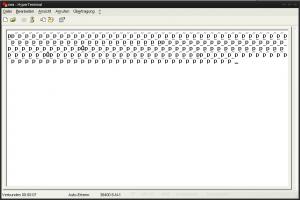

1.- Can you see if jumper is into 4 pins connector? 2.- You change baudrate, from 38400 to others (sometimes the baudrate is configured to 9600) 1. I dont understand what you mean 2. Yes i changed the baudrate to 9600 and i try other USB ports and i try to connect the GND to the GND from the SATA power cable and i try to slow down the FIFO-Puffer from the COM port and i try all that on another PC. Nothing works i only see these garbage characters. I have no more ideas. -

I think that you have connected RX to GND or your cable is wrong. You unconnect the hdd and try null-modem joining RX with TX for check your cable. I try a loopback test with RX and TX wires on the CA-42. The test works. I can see the character in the terminal i typed on the keyboard so the TX and RX i've found on the CA-42 are right. [1234] [sata Data] [sata Power] 1 = empty 2 = GND 3 = TX 4 = RX Nothing happens. 1 = empty 2 = GND 3 = RX 4 = TX Garbage characters. If i disconnect GND nothing happens too. -

You check your cable, join RXs with TXs and put correct baudrate: 38400, 8, N, 1, None If i swapp TX and RX nothing happens in the hyper terminal. The baudrate is correct. -

I connect TX, RX and GND from my CA-42 cable to the hdd. Than i connect a SATA power cable to the hdd, turn on the power supply and connect the CA-42 to my laptop. But everything i can see is his: Whats wrong? -
