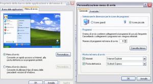

Thank you for the answer. But this is the problem. I found that key because with nlite i made some mistakes and even if i chose to show IE and OE as shown in the image below, IE and OE won't show up due to some reg key i set to 0. Googling around i found that key and setting it to 1 gave me back the choice to show IE and OE. Unfortunately i didn't write somewhere the key and i can't remember it. -
Hi some weeks ago i found the reg key that gave me the choice to show or not the two icons in the start menu showed in the attached image but unfortunately i forgot the reg key. Can anyone help me? Thanks

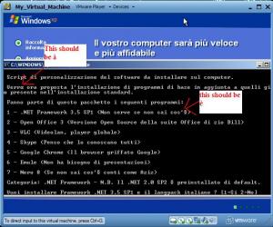

It works great. I'd like to ask you how can insert the alt code in the cmd file? Or how can i know what are other symbols for special characters? For example opening your cmd with notepad you have … = à and Š = è , how can i discover other associations or example for ò or other symbols? Thank you very much -

Sure you are fully right. I used times new roman, is it loaded in the installation of windows xp? This is the screenshot -
Hi I experienced this issue: i have my cmdlines.txt that calls a .cmd file Everything works great but in my echoed text showed during the execution of the .cme file special characters aren't showed correctly, i mean charachters such as è à and so on. Can someone explain why does it happen? Thank you

Hi using nlite and setting 0 icon in the start menu won't give me the possibility to have ie and oe icons in the start menù; even if i check the flag to show ie and oe in the start menu it doesn't work. Instead if I leave default XP options and then set in the panel for customizing the start menu 0 icons i have ie and oe icon in the start menu. Let's have a look at the image: if i leave the default xp option and then i set to 0 i have ie and oe icon in the start menu while if i use nlite and set to 0 i don't have anything and even checking the flag "show ie and oe in the start menu" it doesn't work. Ho can i fix this? Thanks
