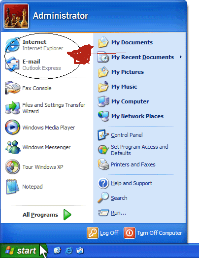

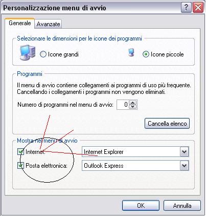

  7. Ok i got it. The key is NoStartMenuPinnedList Thank you.
  8. Thank you for the answer. But this is the problem. I found that key because with nlite i made some mistakes and even if i chose to show IE and OE as shown in the image below, IE and OE won't show up due to some reg key i set to 0. Googling around i found that key and setting it to 1 gave me back the choice to show IE and OE. Unfortunately i didn't write somewhere the key and i can't remember it.
  9. Hi some weeks ago i found the reg key that gave me the choice to show or not the two icons in the start menu showed in the attached image but unfortunately i forgot the reg key. Can anyone help me? Thanks
