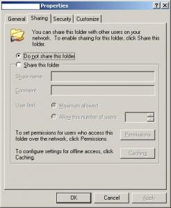

  6. I guess what has me confused is why you have the property window you do, and not the one attached in the picture. I'm on XP Pro SP1 and I always remember my view being like this. Does anyone know what triggers the old traditional sharing settings?

  9. Did you check to see that Simple File Sharing is disabled? Go to Tools > Folder Options > View, then scroll to the very last item and uncheck 'Use Simple File Sharing"
