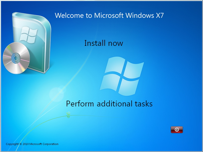

  7. Windows XP Autorun Windows 7 look! Edit:posted in wrong section AutoPlay.rar
