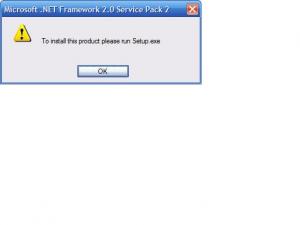

@Strel I just done a test with no RESTRICTED HOTFIXES, just the basic patches, and it wont install on Win2003. When I extracted the files, and run the MSI files from 20/30/35 I get following error. -

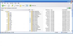

I've been using WPI 7.1.1 for a long time with no problems on WinXP, if I upgrade to WPI 7.7, I have a problem were %CDROM% is not being defined. It may be caused by the way I have my folders structured, but I would prefer not to change it. I have included log files for both 7.1.1 and 7.7 versions. Thanks for any help WPI_Log_7.1.1.txt WPI_Log_7.7.0.txt
