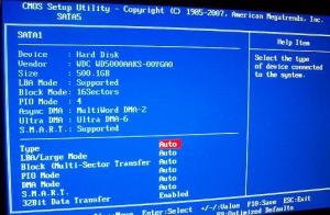

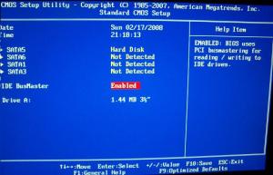

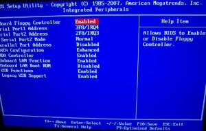

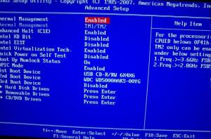

Okay... didn't work... Here are my options in BIOS... I'm including one page that I'm pretty sure has nothing to do with it, just in case... -

Okay, so I'm totally trying this right now... HOWEVER, I don't have any option for AHCI mode on a Sata drive on my Bios... So is there anything else this might be called in my BIOS options? (I'm taking pictures of my options in BIOS now... let me know if that would help, and I'll upload em...) -

thank you very much j7n, however, there are NO legacy PATA connectors... I used the JMicro controller drivers as kind of a hail-mary kinda thing... And if I'm entirely wrong (which is possible) and there ARE JMicron ones, then how would I identify those vs. the ICH9 ones? Because to my understanding the only ones (per the manufacturer) on the board are the ICH9 ones, as it natively would support 6 SATA inputs, but this board (while it has the space for it) only uses 4. (It's a budget board) EDIT: and for the record, in BIOS, I've set up the SATA drives as both ENHANCED and as COMPATIBLE with no different results for either. So, even if I make it Compatible, it's not changing anything. I've even tried plugging the drive into the SATA 5 slot (as technically sata 1&2, 5&6 are available only... there is no 3&4 although the board is ready to accept it should it be sottered in
