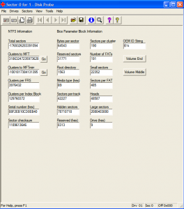

  2. Hi cluberti, Here they are: Old drive Partition Table: NTFS Boot Sector: Thanks for the help!

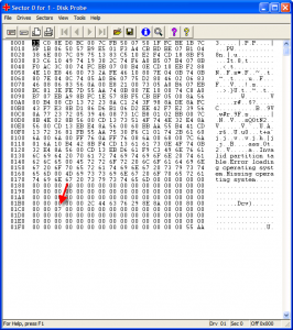

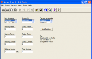

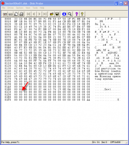

  3. No - if drive recovery software sees the disk and your data, but XP says it's unallocated, you can almost be guaranteed that you simply have flipped bits in sector 1 causing it, which diskprobe can fix. It's just figuring out WHICH bits cluberti: No luck... As you can see, I've changed the 3rd byte in sector 01C0 to 07, but the system still reports an ivalid partition. And no, the magic 42 bit, the Answer to The Ultimate Question Of Life is not present... I'm posting the ORIGINAL faulty sector 1 here, just in case you can get any evidence from it: Also, TestDisk (recommended by Ponch) used to report a valid partition, doesn't do anymore. I'm going to revert my changes to the original status. I did a lot of googling looking for a way to figure this out, but I'm stucked. Any tip? Thanks a lot.
