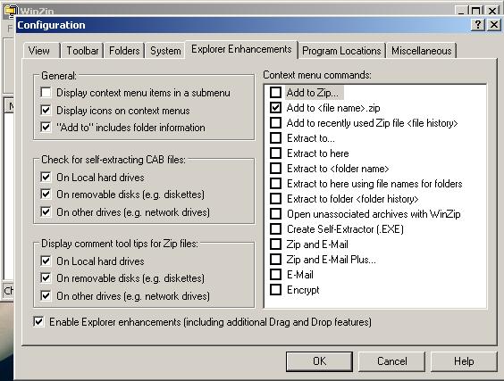

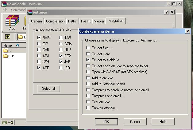

I use winzip for zipping & winrar for extracting files on my machine & know how to make an unattended install of each of them. but i have not been able to make the REG settings unattendedly that i feel like keeping for each of the appz regarding the integration in Explorer Attached are the settings i like to keep for each of them. W;d be really glad if someone can write me the REG file that i can use to Achieve these settings. for winrar For winzip
