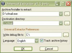

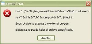

nitro: I'm using uniextract from the "SendTo" menu, I added a link to it: ("C:\Documents and Settings\User22\SendTo\Universal Extractor.lnk") I click the context menu, Send to, Universal extractor, the universal extractor dialog box appears as shown in the picture. I press OK. It gets recognized as Install shield, it offers try cache mode, I click OK, then happen the error showed before, and cfmail gets deleted from D:\ and copied to the uniextract path in D:\Programas\UniversalExtractor\cfmail.exe. Also, the directory D:\cfmail is created and not deleted. You're right again, with install explorer you get garbage in the files. With the messagebox thing, I mean making the msgbox on top of the installer, because the installer cover it, and I didn't see it until I cancel the installer (I was waiting that uniextract did something that had already done, but I didn't see). Sorry for the waste of time, I should triple check things before I post. Thanks!
I made it work in cache mode, I had to move uniextract from the long path "D:\Programas\UniversalExtractor\UniExtract.exe", which is strange since it doesn't have spaces in the path. In "D:\Uni\Uniextract.exe" it worked. You should check what happens with long path names, they're annoying sometimes. Another suggestion would be to put the MessageBox of cache mode on top of the installer, maybe with MB_TOPMOST, so it won't get covered by the installer window, but that's a minor detail. As you probably have guessed I have spanish XP, in the first picture of the previous post, "El sistema no puede hallar el archivo especificado" means: "The system can't find the specified file". And off course, "Aceptar" means "Accept". Thank you, really, you're making a great effort in this utility!

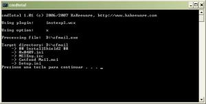

You're right. I didn't try cache mode, but when I tried it gives me the error in the attached picture. The original file is in D:\cfmail.exe, but it gets copied to D:\Programas\UniversalExtractor\, I suppose this is the correct behavior, but it can't be executed. Another mistake is that I used install explorer plugin to extract cfmail, not isshield. That's in the second picture. Sorry for the waste of time, you were right, but I was too, in certain way...
Well, hope it's not too late for another bug. This installer: http://www.catfood.net/products/cfmail.exe (1,4 MB) Uniextract fails and reports an InstallShield (in this case is true: Peid returns InstallShield Stub 2003). I unpacked it with cmdtotal and isshield plugin: http://www.totalcmd.net/plugring/IShield.html It's strange, this wcx is based in i6comp, i5comp, but I tried with those directly and no results. Thanks for everything!
