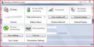

hey, has anybody noticed that Windows Mobility center, while having many great features and apps, is a little disproportionately weighted? I mean, Ill be the first to admit that his is nitpicking, but for me at least there are six separate sections (see picture) and its set up so that there are four on the top row, and two on the bottum. These sections are all of equal size, and from what ive seen they are the same on most computers, wouldnt it have made more sense for the sake of size to have it 3 and 3 rather than have a quarter of the space used in the module go to waste? Or am I missing a setting or feature to do this?
