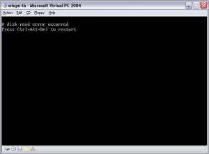

I get the attached screenshot - it never even attempts to boot into the installer. This is right before the textmode portion of the install at the very beginnning.
I am using WinPE 2.0 (Build 5744) to install Windows 2000 and the Windows 2000 install fails after the intial reboot. I have formated the systemdrive using either Diskpart or Format with NTFS using default settings under WinPE 2.0. If I format using FAT32 it works fine, but I am putting together a build CD for servers (FAT32 is not secure enough). Is convert to NTFS an option here? Does this work well? Any ideas on what's going on here and why NTFS in Vista appears to be different? Did anything change with NTFS in this release/build of WinPE 2.0 (Vista)? Could some advanced features of NTFS be on by default (such as Encryption)? I have also tried format.com from Windows XP and 2003 and niether work (they will not execute correctly in Vista). Any suggestions on what to try next? One thing I did notice is that under the "HKEY_LOCAL_MACHINE\SYSTEM\CurrentControlSet\Control\FileSystem" key in the registry the "NtfsDisableEncryption" and "NtfsDisableCompression" are both set to 0 in this build of WinPE. I set these to 1 and re formated the partition but this did not work either (in a few articles I found that referenced these values they said a reboot is required for these values to take). I was able to modify the Hive and set these to 1. But this still did not fix my issue. Any more ideas? Thanks, RC

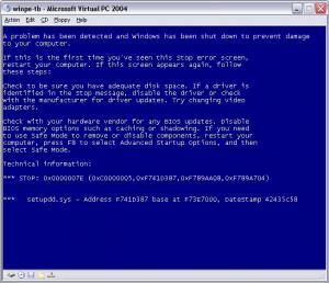

With Win Vista Beta 1 I got as far as a blue screen inside WinPE 2005 before I gave up. But I was hacking the hive to get past the MINIT issue. The stop error I got was: STOP: 0x0000007E (0xC0000005, 0xF741D387, 0xF789AA08, 0xF789A704) setupdd.sys - Address F741D387 base at F73E7000, DateStamp 42435c58 -
