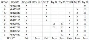

  5. Comparison chart

  8. KB928843, KB926436, and KB918118 don't appear problematic either. I suspect it is KB931836 (DST update) because the point at which setup is failing, it is trying to load registry hives. Since the DST update is the only update to affect the registry, I suspect an integration problem with nLite and this update. I am currently running a test with all updates except for KB931836.
  9. KB928255 and KB924667 don't appear problematic either.
  10. I'm currently working on trying to figure out which update(s) is/are causing the error. So far, I've determined that it is not a problem with KB928090 and KB927779.
