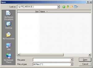

  6. now this is really strange. i have reinstalled .net 2.0 - no change i installed .net 3.0 - no change i installed .net 1.1 - no change i then started NERO and tried Recorder-Burn Image. a File-Open dialog box appears, and it displays the contents of my harddrive as usual. however, when i select "*.*" in the list of filetypes at the bottom of the dialogbox, the content disappears! (see screenshot). so this clearly is not related to .net (nero doesn't use .net) but something different. this is one of many nlite cds i made, and the differences to the previos ones were (as far as i remember them now): - remove active directory (can't be related to this, right?) - removed fast user switching, terminal services, etc (can't be related either) - something with speed up access to avi files (file system filter driver?) - shell hardware driver or something (my drives are named "cd-rom" instead of the content of the disc) - the setting that prevents explorer from reading mp3 bitrates who's got an idea what's causing this issue?

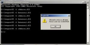

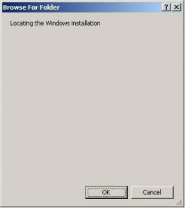

  8. hy, i need your help... i've made an nlite version of xp64 and installed it on my machine, but it seems i removed something critical. so this is what happens: i have downloaded nlite on my freshly installed system to create another customized windows cd. when i start it, the "browse for folder" dialog box appears, but it is empty? see screenshot 1. googling around i found info that this could be a problem in .net, or that this could be fixed with the commands: C:\>regsvr32 /i browseui.dll C:\>regsvr32 /i shdocvw.dll but when i execute those i get the message: DllInstall in xxx failed. Return code was: 0x80004005. see screenshot 2! how can i fix this? thanks for help!

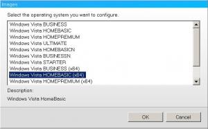

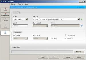

  11. sorry, i have to ask again. i now hit APPLY and chose the REBUILD method. after some time it was done and the final image is still 4.3 something gigabyte. i installed it in vmware and nothing has changed from the original dvd, e.g. the sidebar is still there, etc. the dvd i am using is Vista_RTM_AIO_DVD-WinBeta.iso and i have selected the Vista HOMEBASIC (x64) version. (see screenshot). during install, this selection window pops up again and i again select the Vista HOMEBASIC (x64) version. all other versions are still in the list (???). after install, it displays the selected version at startup correctly, but as i said, i don't see any of changes i made in vlite. my own fault again? or an error in vlite? another note: for simplicity, it would e.g. be nice to select the windows editions i'd like to remove, so i check "business", "ultimate" etc.. and click a "remove" button and they are gone. this IMHO would be an easier and better way than the current "select edition - make changes - hit APPLY" approach. just an idea :=) update: i have tried the whole process again and checked the intermediate directory before creating a new iso. in the folder "sources" there is now only the "x64" folder and the other one (x86?) seems to be removed. so that part is working OK. the installer still shows the "select your vista edition" screen, though. will now try the vmware installation again... :=)
  12. ok forget it. you have to hit "APPLY" for the process to start..... stupid me. you might wanna change this a bit, it isn't that straightforward to see. problem solved, cheers!
  13. hey, first, thanks for vlite... yipppeeeh!!! i just tried my first image, but it didn't really work out - nothing was removed after the install. and my iso was still 4gigs in size. i then read on the net that i have to "rebuild" the image at the "Log" phase... but my vlite skips this step (when pressing NEXT after the tweaks step). also, the button is greyed out. what am i doing wrong?
