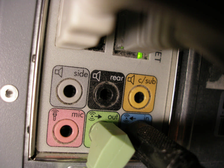

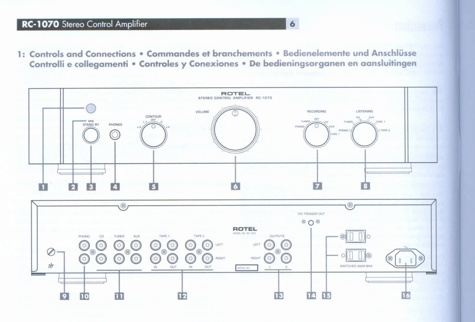

have attachments to view. The graphic equaliser connected via 2 RCA X 2 RCA Tape 1 In & Outs. I have a 2 RCA lead from the outputs of the Stereo Control Amplifier going into the inputs of the Stereo Power Amplifier. The turntable is connected to the Phono In Stereo Control Amplifier. I have a 2 RCA lead connected to the remaining 2 outputs of the Stereo Control Amplifier with a stereo pin plug at the other end going into the Line In on the back of the computer tower. On the front of the Stereo Control Amplifier, the recording dial is on Phono and the listening dial is on tape 1. The graphic equaliser is imperative to the quality of sound. Tank you for your assistance. :rolleyes:

Most likely the static noise you hear comes from your sound card. Another possible cause can be the cables you use, they might be in bad condition. Also if you balance the volume between the amp and sound card so that your amp's volume level is very high and the sound card's level is very low, you will most likely have the static noise coming from your amp. Chaining so much equipment will most likely create some extra noise as well.
