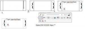

Shoshoni Posted July 19, 2006 Posted July 19, 2006 Step 1 First draw a table (manually) and divide it into three parts (roughly).- Then put your cursor in the left table.- Then increase the font size.Step 2- Now put your bracket there.Do the same for the table to the right.Step 3- Put your cursor in the middle of the table and type your text.Step 4- To finish things off: select "No Edge" (see image).What you are doing is that you make the lines blank so you don't see them when it's printed but they're still there.Of course you must crop and resize the table as you see fit! There you go!
Spookygoffbird Posted July 19, 2006 Author Posted July 19, 2006 Ahhhh.... Never thought to do it in a table.I was getting there with my whacked out column idea.Thanks - that's working perfectly. You're a star

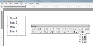

spacesurfer Posted July 24, 2006 Posted July 24, 2006 Here's a better way: Use equation editor, which is not installed by default, but if you have your MS Office CD, do Add/Remove, then install Equation Editor.Here's what it looks like:
