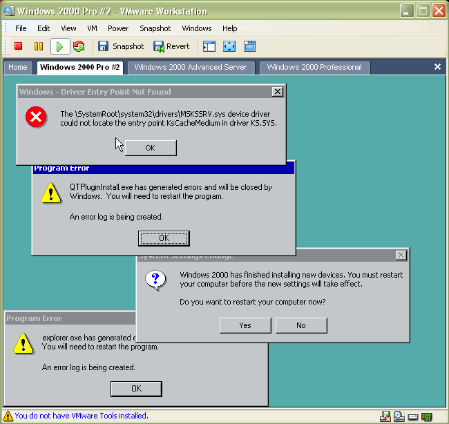

When I try to install DirectX9c and IE6+sp1 via RunOnceEx at first logon with a normal win2k unattended I get these errors.
Look at the image attached. Theres a QuickTime error in there on the screenshot as well. But my latests test was with IE and DX only that resultet in the same errors.
Even though windows bitches and moans, after the reboot IE6 and DX9c are installed and SEEMS to be working as they should.
Help! I need to get rid of these errors.
Only VMware drivers are included in the install.

I get that if there isn't a restart between me installing DX and trying to install codecs. I install DX from my cmdlines.txt and the install codecs sin the guirunonce section. I have had a couple of other problems with dxdiag finding invalid entry points buti solved those by causing a dx reinstall as the guirunonce section exits.
Thanks for the reply Wraith, I'm starting to get reallly f... frustrated.
I'll try installing DX9c during cmdlines, maybe I could sneak in IE6 at that point as well?
Any thoughts on that?
Or maybe, even better, replace IE5 in the Windows 2000 installation files with IE6. Is that even possible.
