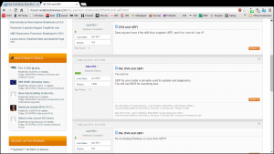

Nevertheless I have learned thanks to you quite a few things: How to use MSFN (and I love it), How to use the xbootmgr and I also got the corresponding MS analyser which may help. Strangely I cannot either access the UEFI.(which seems limited on DV6 anyhow, see attached)
