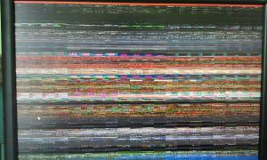

wlw Posted May 3, 2011 Author Posted May 3, 2011 It's playing with me now! Two crashes in a row that look like this:Interestingly, the mouse pointer always stays on top of it, which leads me to conclusion that it's not the GPU's fault (it's not the frame buffer corruption).It stays like this for a while and then the PC reboots itself.I have completely disengaged the UCC module, which is a hardware CPU unlocking solution, so the CPU is back to being a Phenom II x2 550BE on stock clocks and voltage.Above screenshot was taken on the CPU being locked back like this.I also have 2 reports in Event Viewer saying that Software branch of the system registry was damaged and has been recovered. Besides that, nothing unusual.Ram checked from bootable Memtest USB stick, disk checked.
MagicAndre1981 Posted May 3, 2011 Posted May 3, 2011 do you have a different CPU to test? Which GPU do you use?
wlw Posted May 3, 2011 Author Posted May 3, 2011 I do not have a different AM3 CPU to test, however this one has been with me since previous AM2+ board where it worked as dual core and never ever made any problems.The GPU is Sapphire HD6850 1GB and I have tortured it with Furmark and alike and it gently lets you know when there's something bad going on with it, like when overheating or overclocked it will first show some slight shader artifacts (like green dots), if you push it further the display driver will reset itself ("The video driver regained stability" or however this translates) and then, when you drive it way off the edge, it will crash, but never like that. The screen just goes black and that's all, no fancy patterns like on the screenshot.This patter however, I have seen it before, all I have to do is, let's say, launch some Flash videos, easiest way to cause it is to launch Steam, go to Store and play any game trailer - couple of seconds and it's dead.And again, the strangest things of all is that it works for a week, then it goes mad like this when it's crashing, not booting and freezing, and then it works for another couple of days no matter what you do...
