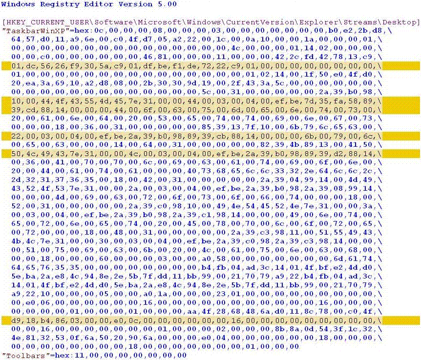

diptenkrom Posted December 8, 2008 Author Posted December 8, 2008 seems as if i got wmp11 and silverlight on okay. i am trying to make rev.3 of my install disc the last one for the time being. the first 2 have been a learning experience, but have not done exactly what i was shooting for. any poiinters on what i can do to make my theme appear and get rid of that annoying error about the user not being able to log on would be great and possibly make my day.i have slipstreamed sp3, ie8, silverlight, wmp11 into the disc. still want to add directX 10.1also is there any way to change the position of the start bar in the setup, like move it to the top of the screen? as you guys have noticed i am not a programmer, but i can implement code, and follow how-to's very well. i am reasonably intellegent and have taken some programming, so i do know some basics, but do not know code by heart. i can however take code and alter it to acheive my goals if given a basis to go from.

iamtheky Posted December 9, 2008 Posted December 9, 2008 http://www.msfn.org/board/Taskbar-Position...try-t11854.html-recommends moving the taskbar, rebooting, then exporting the key.attached is a .bmp highlighting all the changes made to the key when the taskbar is moved (WinXP).
diptenkrom Posted December 12, 2008 Author Posted December 12, 2008 thanks very much!! according to that other thread, i can just copy that file and replace it on my install disc directly?
diptenkrom Posted December 13, 2008 Author Posted December 13, 2008 okay i got the reg entry, where do i put it? or is there somethin i need to do? like runonce, or what?
iamtheky Posted December 14, 2008 Posted December 14, 2008 Yeah, I do all my reg add from cmdlines and runonce .cmds. There is also the regtweaks if you want to try other options. I recommend you build a batch first with the reg add key and make sure it functions before wasting an hour waiting for a runonce to fail.
