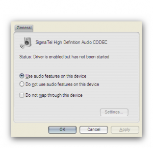

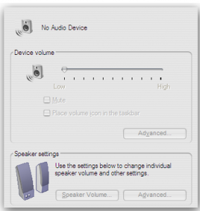

assman21 Posted January 18, 2008 Posted January 18, 2008 (edited) Hello everybody I am new here I have just "Downgraded" my PC from Vista to XP The problem now is I have no soundCard Driver I currently own a Emachines T3604 (They said they dont support XP}Running on windows XP Professional I use the Intel® 82945G Express Chipset Family 6.14.10.4906Everything else was fine it use to run on the Sigma Tel HD Audio CODEC/DriverNow I have no Sound, I tried an earlier version of the same driver and no luckI downloaded 4 automatic driver programs (DriverMagic, DriverGenius) No LuckI downloaded http://driverpacks.net/DriverPacks/ (Driver Packs) With no luck, and also tried all there drivers for Sigma Tel with no luck Now uninstalled all the non working one'sand im left with thisSome more infoEmachines T3604Intel Celeron DWindows XP ProfessionalIntel® 82945G Express Chipset Family 6.14.10.4906AND NO SOUNDIs there any Driver I can use or do I need a specific program? Edited January 18, 2008 by assman21
assman21 Posted January 18, 2008 Author Posted January 18, 2008 ok I read the above StickyI already have Unknown Devices So here is my Link if any one could help PLZhttp://www.halfdone.com/pastebin/?id=813-691

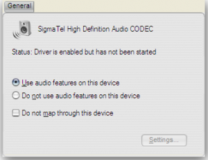

assman21 Posted January 18, 2008 Author Posted January 18, 2008 UpdateI installed the SigmaTel HD Audio Codec 6.10.0.5274ok Im still getting no SOUND lolHere is what they say Status: Driver is Enabled but has not been startedWTF????Im using the Same Driver/Codec found here SigmaTel HD audio Codec http://www.emachines.com/support/product_s...amp;model=T3604Please tell me if im missing something or I have screwed something up, wrong driver etc, etc

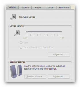

assman21 Posted January 19, 2008 Author Posted January 19, 2008 No one can help?I am really thinking about going back to VistaPlz any advice will be appreciated, I also included all the info need

assman21 Posted January 19, 2008 Author Posted January 19, 2008 (edited) OkI believe I have installed KB888111 and I still have no audio?Currently showingIntel High Definition CODEC The KB888111 Is installed What the hell is going on lol I cant be the only person to ever have this problem, right?I am beginning to feel frustratedif MS did not want us to Downgrade they should of offered a better product lol, Come on I really cant be the only person to ever have tis issueAny further issue is really appreciatedWhen I go to the Command Prompt menu it still tells meStatus: Driver is Enabled but not started Edited January 19, 2008 by assman21
assman21 Posted January 19, 2008 Author Posted January 19, 2008 For some reason im still getting this Why or how is it not started?
cluberti Posted January 19, 2008 Posted January 19, 2008 Either the driver isn't for your hardware, or the install was bad. I'd say it'd be better to know the exact chipset for your hardware and find the driver.Does the event log (system or application) say anything about the issue?
assman21 Posted January 19, 2008 Author Posted January 19, 2008 Either the driver isn't for your hardware, or the install was bad. I'd say it'd be better to know the exact chipset for your hardware and find the driver.Does the event log (system or application) say anything about the issue?Intel® 82945G Express Chipset Family For Emachines T3604 Also I am not really sure but it detects the jacksI also provided http://www.halfdone.com/pastebin/?id=813-691 So you guys can look at my speck Now I still have The sigmatel HD Audio CODEC But no soundit tells me Device is enabled but has not been started
loksie Posted January 23, 2008 Posted January 23, 2008 a friend of mine has a T3604 and was having problems with drivers - i installed the driver and the sound is working using file 9536675.exe from http://support.gateway.com/support/drivers...mp;uid=18486979I also got another one to work but I don't remember the exact file i think it was D00673-001-001.exe Either way the sound is working but DO THIS FIRST - ***remove the folder SF once 9536675.exe unzips to the cabs folder otherwise you will get some error about intel audio studio not being compatible with the motherboard and then you will have to edit the registry to get the audio studio from starting every time the computer starts up and to get it removed from the add/remove programs list*** (that means after you doubleclick the file 9536675.exe - go to the c:\cabs\9536675\ folder and delete the folder called SF)
