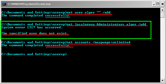

Posted (edited)
hi Arie;
here's the result. though i have exlcuded the registry tweaks nothing changed. alper is still just user but not an administrator. then i decided to apply all the command at useraccounts.cms at a cmd windows and the result is as picture. :unsure:
do you have a comment for such occation ?
edited:
when i use "suleyman" instead of "alper" all commands at cmd window works. so i think the problem is that a user name must be consist of at least 6 digits. because my previous username was userxp and there were no problem. is it true ???
Edited by darksimoon
again hi Arie :)
this time i found the reason :) machine name and user name cant be the same !!!!! :) my computers name is alper and i was trying to make a user called alper too. so i allways getting the error that "specified user does not exist"
thank you very much for your help and encouraging me :))
