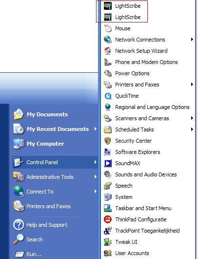

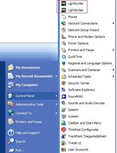

I found out what the problem is with the border. When you open the Control Panel, the icon does have a border. This is how it should indeed look. However, if you open the Control Panel cascaded from the Start Menu, the icon should not have a border. Thank you very much for your help, but please don't bother fixing this "problem". The reply of "os2fan2" above helped me solve this whole issue myself. I downloaded Uuidgen.Exe from the Microsoft web site and used it to generate a CLSID. I used this CLSID in my REG-file, which you can see below. It works like a charm now and the icon displays correctly in the Control Panel (with a border) as well as in the Control Panel when it's cascaded in the Start Menu (without a border); see attached screenshot (the top one in red is mine, the bottom in red one is yours). Thanks again for your help! You too "os2fan2"! Oh, and thanks to "Oisin" for the REG_EXTEND_SZ hint! :thumbup
