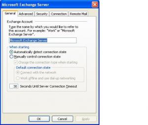

  12. I am a newbie here, and now face some difficulties in outlook2003 installtion. I install this appliaction with mst file in unattend mode. Everything is OK,except one thing.I attach a screenshot for you to get a better sense of what i am concerned. Like the screenshot, I want to select the first option "Automatically detect connection state" with the mst file or by editting registry. But the mst file doesn't provide a entry to config this at least in my eyes. Whoever know this or interest this will be welcome. Thanks, my44186680
