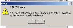

After I have logged in on the citrix server through internet explorer i can't start any puplished application. Getting this SSL/TSL error. "You have not chosen to trust "thawte Server CA". the issuer of the server's security certificate." Tried to install a new cert from Thawte on the client (Windows XP) without any luck. Cleared the trusted certificates. The strange thing that I get this error also on some new installed computers as some old once? But there are just a few in totally that doesn't work. Seems to be a random error. Because just a few are trubled with this. I'm using windows XP clients. And this error is just on some few of the computers. I'm using RIS installation of the clients so all are the same and all the latest patch are also included. Hope someone can helpme here.
After I have logged in on the citrix server through internet explorer i can't start any puplished application. Getting this SSL/TSL error. "You have not chosen to trust "thawte Server CA". the issuer of the server's security certificate." Tried to install a new cert from Thawte on the client without any luck. Cleared the trusted certificates. The strange thing that I get this error also on some new installed computers as some old once? I'm using windows XP clients. And this error is just on some few of the computers. Hope someone can helpme here.
