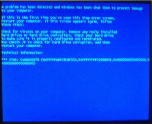

yes its enabledSTOP: 0X0000007B(0XAFFFFFADFC8C0F3C0,0XFFFFFFFFC0000034,0X0000000000000000,0X0000000000000000) I THINK ended me with the same results should i try Remove Components now? Mike well like i said before with the same configureation, same processor, motherboard ram, videocard everything is the same, i had JBOD raid working fine, with windows xp x64, now i wish i could tell you what drivers i used that time but i know i tried them before i even started posting on this site, so if there is a conflict it must only be visable in raid 0 thanks Mike -

ok here is that screen i had, just finished burning the iso and getting ready to install per your instructions 2 posts above Mike -
