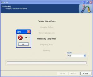

While making a cd using nlite 1.0 RC3, I get and pop-up which tells me the following: PE 13. It looks like an error, and after pressing the OK button, setup simply continues. Is this a known problem? What does it mean? I attached a picture of the problem.
