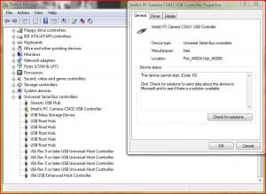

  1. I installed windows Vista the other day and everything went well. IDE raid drivers, sound and video drivers all worked and (as i can tell) no different then windows XP. The problem arose when i went to install the drivers for my Intel CS431 web camera and got a "This device cannot start. (Code 10)" error; to make it short i've tried everything. installing, updating, restarting, manually selecting a driver, and even plugging it in to a different port. I was part of the beta for windows and i had it working and i forgot how; i know the camera is able to work with vista and my computer settings. Attaced is a pictures of the problem, hope it helps. Computer: Windows Vista Ultimate AMD X2 4200+ Raideon X800 AGP 1G Ram 30GB HDD thanks for your time.
