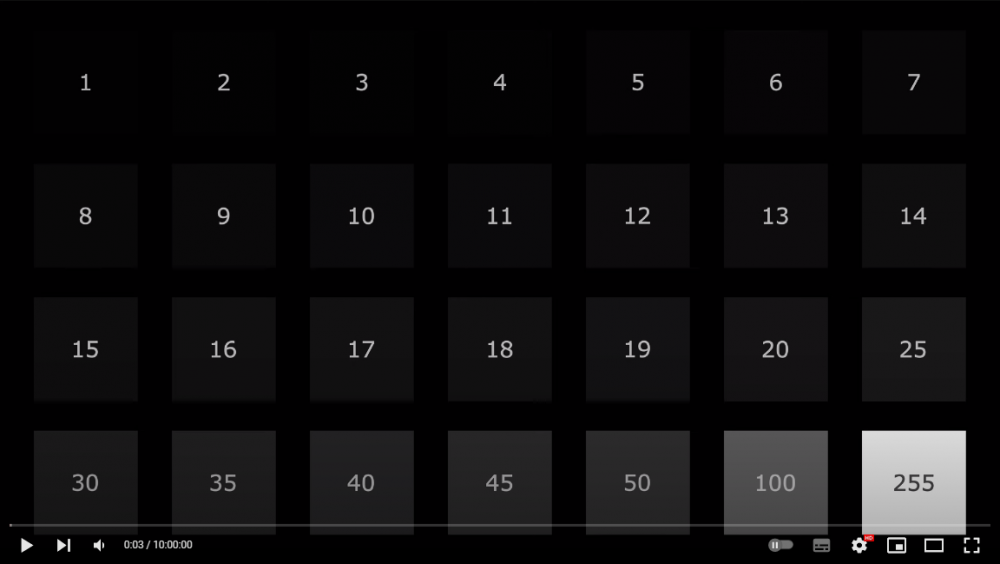

I'm using full range RGB only and still have the problem. The only fix for me is media.hardware-video-decoding.enabled=false (the layers one does nothing), but this is undesirable on some systems due to the extra CPU load, so I'm still looking for a solution. To be honest I was expecting this to be a more common issue than it seems to be, so I'm probably going to have to go through checking a lot of flags to see which one causes the washed out video playback. To clarify again, these two images showcase the difference between media.hardware-video-decoding.enabled on true/false for me:

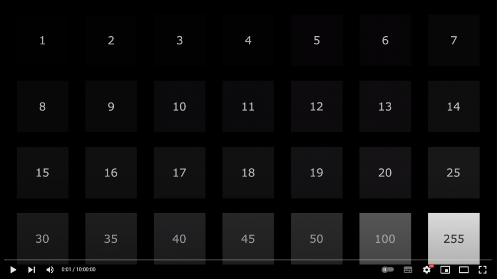

So I just put media.hardware-video-decoding.enabled to false, restarted the browser and am getting different results now: Also verified there's no video engine load while playing the video so it should be software decoded now. Interesting thing is, while this isn't washed out anymore this is actually still different from what Opera is outputting, the white is brighter and in comparison it now seems that Opera has a red tint to the greys? If you download these images and flip through them you can see what I'm talking about. So, is Firefox rendering it correctly now while Opera was giving me bad video too all along? Also as a side remark, media.hardware-video-decoding.failed was already at false and is listed as a changed setting, for whatever that's worth. PS: it just occurred to me that I had h264ify on for Firefox the entire time while it was off for Opera, so I thought this might be related, because Opera was getting an AV1 video previously. However I just turned it on and it doesn't seem to be the cause, here a quick screenshot from Opera to prove it:
Ok, thanks for testing, so I need to look into why this happens only for me then. Some screenshots: Firefox: Opera: I have also found the topic where a missing function in Win7 is mentioned, which is DX11 DXVA, but the topic is 6 years old already so I don't know if that is relevant anymore. I will try to disable hardware video acceleration to see if that makes a difference.
