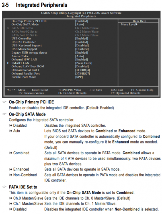

  6. All the unnecessary devices and ports have been disabled prior to installing Windows. Would disabling more than just the HD audio be causing any issues? NUSB33 is an easy thing I can try right away. Also alternate PCI slots for the sound card. But should I be focusing on the basics like the right combo of ACPI and ACHI first? Is HIMEM.EXE compatible with the R.Loew RAM patch? My motherboard doesn't make it totally clear if I'm using AHCI mode. Currently On-Chip SATA Mode is set to Auto. From my understanding, Enhanced would be equivalent to AHCI Mode, then I should disable PATA IDE Is this correct? https://download1.gigabyte.com/Files/Manual/motherboard_manual_ga-p31_ds3_ds3l_s3l_e.pdf That TRIM utility looks excellent. How often would you run it? I guess it depends on how often files are being moved around the drive, right? On a previous attempt I installed with p /j and found more unknown devices in my device manager. I assumed more is bad and it would be easier to just focus on the PCI Universal Serial Bus. No ACPI devices are currently showing under System Devices. There is an ACPI Controller that is identified during boot though. Maybe floppy can be solved by installing a real one and then disabling the device in Device Manager.
  7. Gigabyte GA-P31-DS3L 512MB RAM 60GB SSD GeForce 7600GT Intel E7200 I've just finished an install of Windows 98SE using the "Slipstreamable" Intel Chipset INF Drivers from; The Windows (setup /p i) went really well with nothing abnormal happening. On boot up the device manager reports only one unknown device (PCI Bus). (Edit: PCI Universal Serial Bus.) I tried uninstalling the device using inf files machine2 and MDHDC but had no luck. On a previous attempt I had problems with; Nusb36 - Black screen and freeze but USB devices worked. Tried uninstalling and reinstalling different versions with the same result Audigy 2 ZS - Drivers installed, sound worked but opening the Creative utility to install VxD drivers gave me the error "No driver installed" and no options to install either VxD or WDM drivers. The sound card is not physically installed right now. Unofficial NVidia drivers - Broke my shutdown even with the shutdown patch installed Phantom diskette drive - Even though the floppy drive has been disabled in the bios it still shows in my computer. Sometimes a 3.5 sometimes it's a 5.25. Never shows up in device manager. So now my question is, where to start? Nothing seems to be quite working perfectly and I am not sure how or what I should be troubleshooting first.
