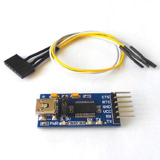

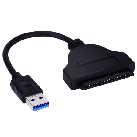

The Solution for Seagate 7200.11 HDDs
CODEBLUE001 replied to Gradius2's topic in Hard Drive and Removable Media
Hi My Seagate Barracuda 7200.11 stopped working in 2009. I never tried to fix it until now. I came across this forum and read up on the solutions, but I can't get past my first road block. I am running windows 10, and I purchased a FT232BM/BL Seagate barracuada 7200.11 firmware fix tool, complete usb from ebay First Road block: My USB 3.0 to SATA Adapter Cable cannot power my HDD. I know it works because it powers my other HDDs Second Road Block: USB 3.0 to SSD/2.5a Sata Dual Bay Hard Drive Docking Station can power my HDD but it's a docking station so it's impossible to connect the firmware fix tool. Please advise Thanks
