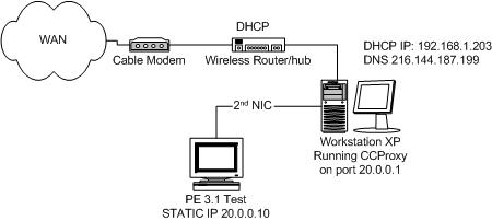

Yes I know about hammering. But like you said, right now it does not work. As soon as a ping starts to work, I will add a delay. :-) This my configuration: Eventually, I will a DHCP and PXE servers to the workstation. But for now, I want the PE test to access the WWW via the ccproxy. Yes, the workstation shows 216.144.187.199 as the server, in the control window as well as ipconfig.sys. However, on the workstation I can not get a response from any of the three DNS servers with pings. (What???!!) On the PE test, i can ping 20.0.0.1/ Years ago, I had this config working with win 95. Any ideas? steve Steve
I have a winPE 3.1 image that loads from CD of PXE. My desired application, BOINC, runs well. However now I would like to network 10-20 PE3.1 computers onto a sub-network. This network will be tied to a XP computer that will store the images and provide interface to the WWW. In this server I will use ccproxy. However, I am having trouble setting up the PE to interface with the server ccproxy. So far the following lines do not work. netsh int IP set address name="local area connection" static 20.0.0.5 255.255.255.0 20.0.0.1 netsh interface ip set dns name="Local Area Connection" static 216.144.187.199 ipconfig /all pause :LOOP ping www.google.com goto :LOOP Using this test, it appears the DNS is not working yet. ( I have ccproxy set up for DNS and HTTP services) Any ideas? Thanks in advance. Steve
