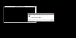

Hi everyone, I've run into an error with something that I'm not able to understand and fix over the past few days. This error has been driving me crazy and I've tried almost everything available on the web, nothing has worked. Here is the problem. I've a SetupComplete.cmd script under this location D:\RemoteInstall\Images\WIN 7\install\$OEM$\$$\Setup\Scripts. This script maps a network drive and then run another script to install bunch of apps silently. This was working fine until few days back it started giving out an error "windows cannot find the "blah blah (apps). Make sure your name is typed correctly and so on. I tried everything from running anti-virus, malware, checking environment variables, cmd.exe inside system32 folder, you name it, none of it worked. I then re-install Server 2012, tried all over again, same result. Script runs at the FirstLogon in unattended install but fails with the same error. So, what I did, I ran the SetupComplete.cmd both as an Adminstrator and as a user to see if it run and does what it suppose to do, it ran but it threw up a different error directly from the server. What I found weird in the script is that it adds one extra Apps folder name into \\10.8.8.3\Apps\Apps when it should be just one Apps folder as it was before few days back. When I open up the SetupComplete.cmd, it only shows one Apps folder, but when I run it, it shows two Apps folders. This is where the problem is because an extra Apps folder preventing the apps to install silently. I'm not able to understand how this extra Apps is shows up when running the script. I even deleted and re-created a new SetupComplete.cmd script and also the file Script.bat which contains all the switches to install the apps silently. It didn't work. Attached is the screenshot of the error. Can someone please tell me what's going on with this and the solution to fix it? I'm really tired searching for solution online. Looking forward to hear from someone. Thanks
Hi GreenEnvy, Can you please help me out? I followed the same procedure as you have to have the apps installed during the unattended install. The only thing I did is added a FirstLogonCommands under OOBE pass and point the path to my network share where setupcompletec.cmd and Apps.batch script is located. I tried this and it threw up error message as you can above. Then I changed the commandline from "cmd /C start /wait E:\RemoteInstall\Images\Windows8\install\$OEM$\$$\Setup\Scripts\SetupComplete.cmd" to this \\WDS-DEP-SERV\E\RemoteInstall\Images\Windows8\install\$OEM$\$$\Setup\Scripts\SetupComplete.cmd but it didn't not even run. Do I have to pass any command parameters anywhere inside my unattend XML file, so the client can pull the script and run it from the network share during unattend install. I'm really having a hard time with this. Could you please shed some light? How do you have it in your unattend xml file? Hope to hear from you soon! <FirstLogonCommands> <SynchronousCommand wcm:action="add"> <CommandLine>cmd /C start /wait E:\RemoteInstall\Images\Windows8\install\$OEM$\$$\Setup\Scripts\SetupComplete.cmd</CommandLine> <Description>Various Apps Installation</Description> <Order>1</Order> < RequiresUserInput>false</RequiresUserInput> </SynchronousCommand> </FirstLogonCommands

Hi, I ran into an error when my script "SetupComplete.cmd" failed to run from network share right before the fist login. Script is on my WDS server. Attached is my error message during unattend install. Can someone please take a look at my unattend XML file and see why it didn't execute it? <?xml version="1.0" encoding="utf-8"?><unattend xmlns="urn:schemas-microsoft-com:unattend"> <settings pass="specialize"> <component name="Microsoft-Windows-Shell-Setup" processorArchitecture="amd64" publicKeyToken="31bf3856ad364e35" language="neutral" versionScope="nonSxS" xmlns:wcm="http://schemas.microsoft.com/WMIConfig/2002/State" xmlns:xsi="http://www.w3.org/2001/XMLSchema-instance"> <ComputerName>WIN-8-DEPL</ComputerName> <ProductKey>MHF9N-XY6XB-WVXMC-BTDCT-MKKG7</ProductKey> <RegisteredOrganization>Microsoft</RegisteredOrganization> <RegisteredOwner>Microsoft</RegisteredOwner> <ShowWindowsLive>false</ShowWindowsLive> <TimeZone>eastern standard time</TimeZone> <CopyProfile>true</CopyProfile> <BluetoothTaskbarIconEnabled>false</BluetoothTaskbarIconEnabled> </component> <component name="Microsoft-Windows-Deployment" processorArchitecture="amd64" publicKeyToken="31bf3856ad364e35" language="neutral" versionScope="nonSxS" xmlns:wcm="http://schemas.microsoft.com/WMIConfig/2002/State" xmlns:xsi="http://www.w3.org/2001/XMLSchema-instance"> <RunSynchronous> <RunSynchronousCommand wcm:action="add"> <Order>1</Order> <Path>net user administrator /active:no</Path> <Description>Enabling Built in Administrator Account</Description> <WillReboot>Never</WillReboot> </RunSynchronousCommand> <RunSynchronousCommand wcm:action="add"> <Description>DisableNetworkLocationPrompt</Description> <Order>2</Order> <Path>REG ADD "HKLM\SOFTWARE\Policies\Microsoft\Windows NT\CurrentVersion\NetworkList\Signatures\FirstNetwork" /v Category /t REG_DWORD /d 00000000 /f</Path> <WillReboot>Never</WillReboot> </RunSynchronousCommand> <RunSynchronousCommand wcm:action="add"> <Path>REG ADD HKLM\System\CurrentControlSet\Services\Tcpip6\parameters /v DisabledComponents /t REG_DWORD /d 0xFF /f</Path> <Order>3</Order> <Description>Diasbling IPV6</Description> <WillReboot>Never</WillReboot> </RunSynchronousCommand> <RunSynchronousCommand wcm:action="add"> <Credentials> <Domain>Mikasa.local</Domain> <Password>Ghtwhts2015</Password> <Username>Administrator</Username> </Credentials> <Path>\\WDS-DEP-SERV\E\Distribution\Drivers\setup64.exe /s /v "/qn REBOOT=ReallySuppress" /l C:\Windows\Temp\vmware_tools_install.log</Path> <Order>4</Order> <Description>Vmware Tools Installation</Description> <WillReboot>Always</WillReboot> </RunSynchronousCommand> </RunSynchronous> </component> <component name="Microsoft-Windows-IE-InternetExplorer" processorArchitecture="amd64" publicKeyToken="31bf3856ad364e35" language="neutral" versionScope="nonSxS" xmlns:wcm="http://schemas.microsoft.com/WMIConfig/2002/State" xmlns:xsi="http://www.w3.org/2001/XMLSchema-instance"> <DisableAccelerators>true</DisableAccelerators> <DisableFirstRunWizard>true</DisableFirstRunWizard> <Home_Page>www.marca.com</Home_Page> <BlockPopups>yes</BlockPopups> </component> <component name="Microsoft-Windows-TerminalServices-LocalSessionManager" processorArchitecture="amd64" publicKeyToken="31bf3856ad364e35" language="neutral" versionScope="nonSxS" xmlns:wcm="http://schemas.microsoft.com/WMIConfig/2002/State" xmlns:xsi="http://www.w3.org/2001/XMLSchema-instance"> <fDenyTSConnections>false</fDenyTSConnections> </component> <component name="Networking-MPSSVC-Svc" processorArchitecture="amd64" publicKeyToken="31bf3856ad364e35" language="neutral" versionScope="nonSxS" xmlns:wcm="http://schemas.microsoft.com/WMIConfig/2002/State" xmlns:xsi="http://www.w3.org/2001/XMLSchema-instance"> <FirewallGroups> <FirewallGroup wcm:action="add" wcm:keyValue="Remote Desktop"> <Active>true</Active> <Group>Remote Desktop</Group> <Profile>all</Profile> </FirewallGroup> </FirewallGroups> </component> <component name="Microsoft-Windows-TerminalServices-RDP-WinStationExtensions" processorArchitecture="amd64" publicKeyToken="31bf3856ad364e35" language="neutral" versionScope="nonSxS" xmlns:wcm="http://schemas.microsoft.com/WMIConfig/2002/State" xmlns:xsi="http://www.w3.org/2001/XMLSchema-instance"> <UserAuthentication>0</UserAuthentication> <SecurityLayer>1</SecurityLayer> </component> <component name="Microsoft-Windows-Security-SPP-UX" processorArchitecture="amd64" publicKeyToken="31bf3856ad364e35" language="neutral" versionScope="nonSxS" xmlns:wcm="http://schemas.microsoft.com/WMIConfig/2002/State" xmlns:xsi="http://www.w3.org/2001/XMLSchema-instance"> <SkipAutoActivation>true</SkipAutoActivation> </component> </settings> <settings pass="oobeSystem"> <component name="Microsoft-Windows-Shell-Setup" processorArchitecture="amd64" publicKeyToken="31bf3856ad364e35" language="neutral" versionScope="nonSxS" xmlns:wcm="http://schemas.microsoft.com/WMIConfig/2002/State" xmlns:xsi="http://www.w3.org/2001/XMLSchema-instance"> <AutoLogon> <Password> <Value>RwBoAHQAdwBoAHQAcwAyADAAMQA2AFAAYQBzAHMAdwBvAHIAZAA=</Value> <PlainText>false</PlainText> </Password> <Enabled>true</Enabled> <LogonCount>10</LogonCount> <Username>DarkKnight</Username> <Domain></Domain> </AutoLogon> <OOBE> <HideEULAPage>true</HideEULAPage> <NetworkLocation>Home</NetworkLocation> <ProtectYourPC>1</ProtectYourPC> <HideOEMRegistrationScreen>true</HideOEMRegistrationScreen> <HideWirelessSetupInOOBE>false</HideWirelessSetupInOOBE> </OOBE> <UserAccounts> <AdministratorPassword> <Value>RwBoAHQAdwBoAHQAcwAyADAAMQA2AEEAZABtAGkAbgBpAHMAdAByAGEAdABvAHIAUABhAHMAcwB3AG8AcgBkAA==</Value> <PlainText>false</PlainText> </AdministratorPassword> <LocalAccounts> <LocalAccount wcm:action="add"> <Password> <Value>RwBoAHQAdwBoAHQAcwAyADAAMQA2AFAAYQBzAHMAdwBvAHIAZAA=</Value> <PlainText>false</PlainText> </Password> <Description>Admin User Account</Description> <DisplayName>DarkKnight</DisplayName> <Group>Administrators</Group> <Name>DarkKnight</Name> </LocalAccount> </LocalAccounts> </UserAccounts> <RegisteredOrganization>Mikasa</RegisteredOrganization> <RegisteredOwner>Mikasa</RegisteredOwner> <ShowWindowsLive>false</ShowWindowsLive> <TimeZone>eastern standard time</TimeZone> <FirstLogonCommands> <SynchronousCommand wcm:action="add"> <CommandLine>cmd /C start /wait E:\RemoteInstall\Images\Windows8\install\$OEM$\$$\Setup\Scripts\SetupComplete.cmd</CommandLine> <Description>Various Apps Installation</Description> <Order>1</Order> <RequiresUserInput>false</RequiresUserInput> </SynchronousCommand> </FirstLogonCommands> </component> <component name="Microsoft-Windows-International-Core" processorArchitecture="amd64" publicKeyToken="31bf3856ad364e35" language="neutral" versionScope="nonSxS" xmlns:wcm="http://schemas.microsoft.com/WMIConfig/2002/State" xmlns:xsi="http://www.w3.org/2001/XMLSchema-instance"> <InputLocale>en-US</InputLocale> <SystemLocale>en-US</SystemLocale> <UILanguage>en-US</UILanguage> <UserLocale>en-US</UserLocale> <UILanguageFallback></UILanguageFallback> </component> </settings> <settings pass="generalize"> <component name="Microsoft-Windows-Security-SPP" processorArchitecture="amd64" publicKeyToken="31bf3856ad364e35" language="neutral" versionScope="nonSxS" xmlns:wcm="http://schemas.microsoft.com/WMIConfig/2002/State" xmlns:xsi="http://www.w3.org/2001/XMLSchema-instance"> <SkipRearm>1</SkipRearm> </component> </settings> <settings pass="offlineServicing"> <component name="Microsoft-Windows-LUA-Settings" processorArchitecture="amd64" publicKeyToken="31bf3856ad364e35" language="neutral" versionScope="nonSxS" xmlns:wcm="http://schemas.microsoft.com/WMIConfig/2002/State" xmlns:xsi="http://www.w3.org/2001/XMLSchema-instance"> <EnableLUA>false</EnableLUA> </component> </settings> <cpi:offlineImage cpi:source="wim:e:/windows-os-images/win8.1x86ent-wimfiles/install.wim#Windows 8.1 Enterprise" xmlns:cpi="urn:schemas-microsoft-com:cpi" /></unattend> -
