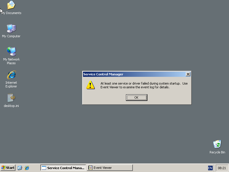

Well, it doesn't work well with my nLite configuration. Oh, and sorry for the double post. First, it showed me this error: But I deactivated the antivirus and it was gone. But each time I start Windows it says: The event viewer: I made an experiment: from the updates downloaded by WSUS I erased all that could cause problems. After the installation the only problem is that the manual update using IE and update.microsoft.com doesn't work anymore. It's just searching without stopping... You'll notice from Last session.ini that the Automatic update service it's stopped but the manual update should of worked anyway. Last Session.zip
