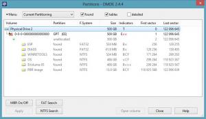

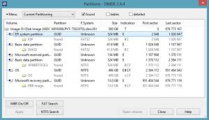

  2. Well here is one for you. I changed sector size on testdisk to 512 ran a quick search it found the partitionas like dmde. I then decided to put in in the laptop and try the recovery disk "automatically repair" and it found the boot and os partitions and repaired them. I am able to boot to windows now no problems.

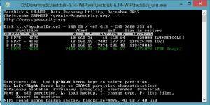

  3. Running Testdisk deeper search was taking forever I would have leave it tonight if you think that testdisk will help. Im a bit clueless on gdisk :

  5. Most likely user error lol As far as it will let me go. Clicking quick search does nothing. Seems like it freezes. edit: Apologies it just took forever to change to searching.

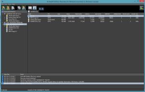

  6. Here is the initial scans as I wait for the fat and ntfs scans: Capture9 is drive itself Capture10 is the image of the disk I took before anything ran on it.

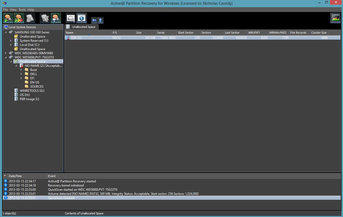

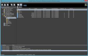

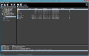

  7. Ok I have managed to read through I see what your saying. I think we are just missing that one partition. Laptop is a Inspiron 3520 I read what you said about boot/ boot\BCD and upon browsing the forth partition in Active@ found them (see attachments) I do apologise if I am missing some of what you are saying or being dumb and not reading properly.
  8. If you try boot it just says bad sector press any key. I believe its just dell standard or out the box configuration I've read that it is meant to have 6 partitions. http://en.community.dell.com/support-forums/software-os/f/4677/p/19494111/20312796.aspx That is a while lot of info you have posted I am having difficulty reading on my mobiles screen and will have to have a proper read throughout the post when I am home late tonight. I think it looks like 2 fat partitions are missing?

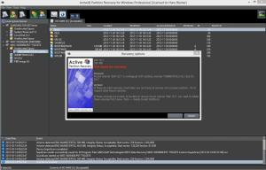

  9. Well, I have no idea which format that tool uses, dsfo/dsfi is simply a (very small/compact) dd-like tool and only operates with "RAW images", and as such it is only compatible with "pure" dd-like tools. Well testdisk won't write data, and as well getdataback won't (of course unless you explicitly tell them to write on the disk), cannot say about that other Active tool. If, by any chance, the .dim image is not a RAW image and the dsfi command "went through" even partially it is very probable (please read as certain ) that the result will be completely "botching" the hard disk. If you want my advice, STOP fiddling with that disk, NOW! jaclaz Noted. Strange thing is with getdataback partitions suddenly appeared readable in windows after a quick search which was strange..... The image is a raw image created by Active@ So as to where to go from here. Obviously I have that Image from 1st usage. I can open it and recover any files there though there is not much data. The whole purpose is to try and recover the partitions etc and learn. In worst case scenario I can just format and resinstall windows. I do really appreciate your help no matter which way it goes.

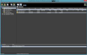

  11. Maybe not that, but it does appear that the software is warez. I understand your problem here. You must have the same edition to be able to spot that straight away. I do however have a license for partition recovery, I do apologise for the screenshot I will change the license to my paid for version and re-snip To add Jaclaz before I done anything I mage an image with active partition its a dim file how can I write this back to the drive I try and get
  12. Hi Jaclaz seen you pop up in every thread I came across with similar issues. Lets hope I become a happy bunny too lol Thanks for your help. I'm not sure if anything has been altered. testdisk.zip
  13. Hey guys I've come across your community after some google searching and have seen some well versed folks in partition recovery. My issue here is a laptop running windows 8 appears to have had a hard shut down thus messing up the partitions or something. I must note I am a newbie when it comes to in depth. I have imaged the disk, twice actually once with Active partition and once with dsfok. It appears that the FAT32 partition for the boot is overlapped by two other partitions as shown in the attached pic Im not sure what I need to do here. I am a novice. Thanks for any help in advance
