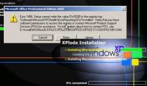

  3. So what was the error all about? Is this going to somehow affect how Office runs in the future? I didn't really mess with the programs just opened word to see if it worked. It didn't act peculiar or anything. Seemed normal.

  5. I replaced the setup.exe file with the one you supplied and I got an error. I was able to click ignore for the error and Office still installed though and appears to be working correctly.
