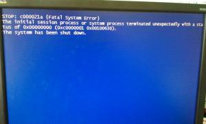

It happened when I powered the PC on and walked away as I usually do when it boots up. When I returned I was welcomed by that screen. However I gave it a hard reset and it's working normally (well, within it's own "norm", that is...) and it has been working ok for a whole day today, even without the crazy tower fan. So it's like it used to be, couple of days of crashes and then a week of peace.
