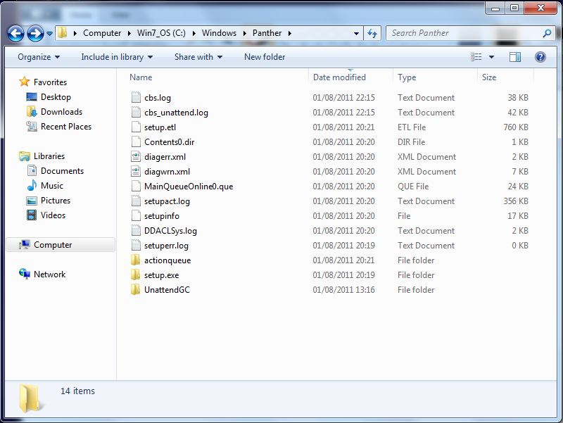

  3. Hi all I'm struggling with understanding exactly when the specialize pass runs. I have an autounattend.xml that I'm using to install the 'base' OS. It does the unattended install exactly as I require, and then boots into audit mode. I then perform any necessary customisations and app installs, then do a sysprep /generalize /oobe / shutdown My understanding is that after generalize, the specialize pass runs at first startup (prior to oobe). Is that correct? What's confusing me is that in the unattend.xml in c:\windows\panther - which seems to be a copy of my autounattend.xml, there's the following 'flag': <settings pass="specialize" wasPassProcessed="true"> If the specialize pass was already processed when the system was building from autounattend.xml, does it actually run again after generalize? Also - in order to get into Audit Mode my autounattend has the Reseal mode set to Audit. So, same question again really - if OOBE pass has been already processed (to get me into Audit mode) does it run again after sysprep /oobe /generalize. Or do I need two answer files? One to get the base OS onto the reference machine, and then another to perform final customisations. Thanks in advance for any advice.
