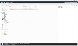

I do not believe it! Its that simple! Haha, John, sir you are a genius thank you VERY much Soa ll i do to stop it going read only is to add that to the RunOnce? How would i go about using copy or xcopy? With a .bat? Myles

Hi John, I found the compressed version allright, All i do is once nlite is on the "Make ISO" screen and it says Explore ISO, I copy and paste my $Docs folder into the $OEM$ folder then click Make ISO, I then just use the ISO in VMWare to install XP, I am currently running the ISO with your exact settings (Had to remove the runonce stuff) If it doesnt succeed this time i will remove $Docs and then install that way with some components removed to see if it works, Myles

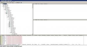

Hi John, Just tried under XP and EXACTLY the same problem, I would apprecciate it anyone else has used nlite to create an ISO would create a virtual machine and test out PiFast on their installaion: http://pifast.hexus.net/hexus_pifast.zip I really dont get it So strange, Its like its looking for a library that isnt there? Myles

Hi John, Yep its running under 7 but i cant see how it would really be a problem, that said i can try it on XP if needed, The ISO i am manipulating is an XP install with SP3 already integrated, I tried the runtime but no luck, Yep thats the correct version it works when i run the normal ISO under VMWare but as soon as i even use an untouched nlite SIO that is generated from the same ISO it wont work so it is DEFINATLY an nlite issue, Regards, Myles
