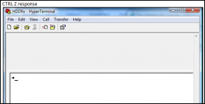

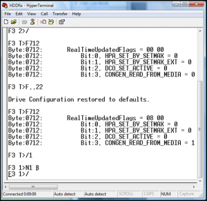

Since my 2/25/2010 post, I've scoured about and seen a few comments noting terminal responses of "small arrows" but none (so far) of the "beta character" I received in response to the N1 (S.M.A.R.T. erase & creation of S.M.A.R.T. sector). Does anyone have any information on these responses to terminal commands or recommendations of additional places to research? Note that these are received from a properly connected HDD (connections were not changed between expected responses and these 'odd' responses). My 2/25/2010 post displays the overall terminal session with a screenshot in the case of the beta character since the overall session translated it to an accented a character. At this point I am contemplating an attempt to hook the drive back up via USB to assess if it is noted in BIOS, though I doubt it would be based on the small arrow response to the CTRL-Z terminal command. I have refrained from further terminal commands or operation in hopes I could find additional information on beta character responses to the N1 command and the small arrow response. So, at this point additional input would be most appreciated. Thanks. -

First thank you to Gradius for your posts. Between this and overclocker.net and a few others I managed to get almost there... Please excuse that this is a partial re-post of what I noted last night(this morning) on overclocker.net... Any assistance would be most helpful... Has anyone else, gotten only a small arrow in hyperterminal when entering CTRL-Z and recovered? Working with a ST3500320AS HDD w/ BSY problem (or at least I believe that was it since it wasn't recognized on boot up one day, no sounds, just no longer accessible). Got all the way thru step 11 (entering N1) after successfully completing 1-8 of the guide as well as the optional F712 commands. Then things went to heck. [Referenced both this forum and the guide, and began using the commands on page 1 here... http://www.overclock.net/hard-drives-storage/457286-seagate-bricked-firmware-drive-fix-pics.html] The terminal response when I entered N1 was a beta character on the same line, then the F3 T> prompt. Figuring it might be okay, I continued and at step 12 received the F3 T> prompt also. I powered the HDD down for 20 seconds while still connected, then powered back up. The caret remained underneath the F in the last F3 T> prompt. But I went ahead and typed in the m0,2,2,0,0,0,0,22 command and enter. The HDD simply continued to spin, no hyperterminal response. Finally after 10-20 minutes I powered it down and disconnected the hyperterminal session. I then re-placed the business card blocking data connection on the PCB and disconnected the USB (CA-42) cable readying for another attempt. This time hyperterminal responded to the CTRL-Z with a small arrow and nothing more. So, I'm wondering (1) Did anyone else get the beta character after N1 was entered? (2) Anyone else get the small arrow? (3) Is the HDD now toast for some reason? (4) Should there have been a CTL-Z *before* the m0,2,2,0,0,0,0,22 command to 'wake up' and get you back to the F3 T> prompt after power down of the HDD for 10-20secs? (5) Any hope for my data?? Thanks to all those who've generously provided instructions and troubleshooting on this and other forums. Your assistance is invaluable! Here are some screenshots: Attempt #1 - N1 beta response (hyperterminal screenshot) Attempt #1 - all commands entered & response (ht copy, note it doesn't capture the beta but an accented a instead) Attempt #2 -- CTRL-Z response (ht screenshot)
