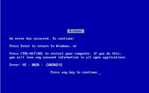

Yes & it behaves properly as if disconnection occurred correctly. This mentions Client: Windows XP or above & Server: Windows Server 2003 & higher. Holding off on these 2 updates for the moment. BTW - The latest BSOD showed: " error : 0D : 0068 : 000029EA " Which may or may not be the same or related to the VxD one. To jaclaz - - I'm no fan of NAV or Roxio either. My suspicion is WMP (which has some connection to Roxio but it also is in a Logitech [webcam] folder so I don't want to remove it completely) however, instead of those 2. Also I would have to completely uninstall NAV to get rid of everything that has nav in the filename - some 20 objects (dll's, .vxd, .sys, .exp).
Yep they are all legit & on system before 2008. IPVNMON = Visual Network Monitor RT WINDOWS = REALTIME EXECUTIVE Most NAV related tho' the 2 above I'm not sure what they are (exc. maybe VPN related & Real Player related "thing") but they been there. They almost always occur after having had an ext HDD connected then dis-connected but usually not until I go to reboot. It has happened a few times going from 1 partition to another in Windows Explorer as well - in which case the BSOD is immediate. Neither scenario occurs every time so isn't reliably re-creatable....if that's even a word!

Yes, I renamed the existing one then added it & rechecked - it IS 5.0.2195.6891. (idk if it matters but USBHUB.SYS is 4.90.3000.0). Strangely the BSOD's don't occur right when the ext. HDD (or drives) are "disconnected" - only later, whenever it is I go to restart. Sometimes it will be the BSOD as attached here. Other times it will be one saying "disk write error" (idk if any "write errors" actually occurred or not). I'm pretty sure the BSOD's are related to the 1TB ext HDD (required) changes since I'd been using my other ext. HDD and a Card Reader for several years w/o ever having a BSOD. No matter, it is a fairly "manageable" problem.
