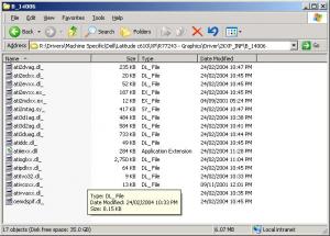

I am using the drivers off the dell site. Probably not the best idea but its what my company wants to do Ok i am probably not the best at explaining things so here i go again...I will try and attach a file and if it doesnt work it pretty much screws up what i am trying to say. The attached file is the current structure of how the driver was extracted. You should see all the dl_ and other compressed files i was on about in B_14006 folder. The inf/ini/cat files are in the folder up (2KXP_INF). So my question was does it matter they are compressed type files and do i keep the same folder structure when i put it in the drivers folder on my xpcd? If you need a bit more detailed explanation then just say so and i will try my best Cheers Nick
ok i have an ati driver for a laptop. i have found the drivers for it and going to put it in my xpcd but got couple of questions: 1 there are alot of files with dl_ and other compressed files. will windows be ok with that or shall i expand them? 2 currently it is setup from how i extracted it with the inf's and ini's in a folder and then a folder under that (called B_14006) with all the compressed files. do i keep it in the same file structure right? or should all compressed files and ini's/inf's be in the same folder? my guess is no need to uncompress the files and keep in same file structure but just wanted to confirm that cheers nick
