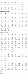

I'm reading the Intel's and Nvidia's topics. Great ones Fernando... It's very helpfull! I really would like to understand it all if possible and I promisse you I won't take you those 900 days! John, Fernando, other members, could you help on this Post #6, please? I uploaded a picture for better understanding. I really apreciate your help and explanation. Thank you...
Right. I'm becoming an expert in nLite... Thanks for the patience and great explanations John, Fernando, and forum contributors. This is just a matter of days for me to become a geek - maybe some 900 days. Fortunately we can count on great techers around here Looking at my drivers folder, in general I see an TXTSetup.oem for (inside folder): (Intel) Matrix Storage Manager Driver (Intel) AHCIx (Nvidia) nForce Serial ATA Controller (Nvidia) RAID host controller And I see an TXTSetup.oem for Network drivers Edit. Here is a picture: So, help me understanding it: G.) Can't I include the Intel's, Nvidia's and Network's drivers in the Drivers Page of nLite? I mean, click the option "Folder with multiple drivers" and selectiong the .INF file(s) on each folder and selecting everithing that it shows me since it is X86 based drivers. H.) What will happen if I do it? And what about the Network drivers, all their folders does contain an TXTSetup.oem. So can I or can't I click the .INF files and get them installed/working during the XP instalation? This kind of things is complicated for me to understand since most of the folders does have a TXTSetup.oem file. I.) With "the other drivers can be placed in nLite at the same time" you mean that drivers that does not contain an TXTSetup.oem file inside their extracted folder? Please, explain a bit more it if possible. Thank you for contributing with the progress of us all!
