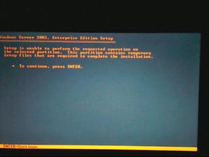

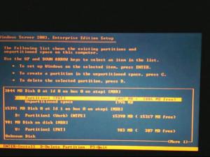

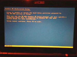

How you define path to Windows install?
I try install Windows NT (copy in DOS mode distrib to SSD and run winnt /b. First step complite successful, but on second after mass storage setup, wroute "unable to locate the hard drive partition prepared by MS-DOS portion of Setup"
)Now I try install patched by WinSetupFromUSB Windows 2003 Enterprise, and setup wroute same error.
And I can't delete partition with Windows NT setup, created before installation from Windows 2003 setup.
What is wrong?
I used ASUS EEE-PC 900.
