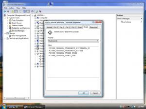

Fernando, Yes I did try your updated Drivers with the addition of the MPC73 hardwareID. I did not see any hard drives, just the unknown ones. I made two different CD's as a check. I am attaching the screen shot of the HardwareID for the ATA controller. BTW When I downloaded the file 'Fernandos_XP_32bit_NF4-7_Performance_Pack_v5.0b.zip' I got "Bad Zip File Offset" error in Winzip when I tried to extract the files, so I used the previous post with the : changed to a ;
Fernando, Here are my Hardware IDs For the "nVidia nForce RAID Controler" ACPI\NVRAID20 *NVRAID20 For the "nVidia nForce Serial ATA Controller" PC\VEN-10E&DEV-07F8&SUBSYS_01371025&REV_A2 PC\VEN-10E&DEV-07F8&SUBSYS_01371025 PC\VEN-10E&DEV-07F8&CC_010484 PC\VEN-10E&DEV-07F8&CC_0104 For the "Standard Dual Channel PCI IDE Controller" PC\VEN-10E&DEV-056C&SUBSYS_01371025&REV_A1 PC\VEN-10E&DEV-056C&SUBSYS_01371025 PC\VEN-10E&DEV-056C&CC_01018A PC\VEN-10E&DEV-056C&CC_0101 Any help? JD Fox
