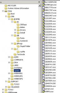

The files are posted on the web at http://www.soc.msu.edu/XP/index.htm The attached picture is my folder structure for a NETWORK install.

I got it working using MS folder layout. See the url above.
