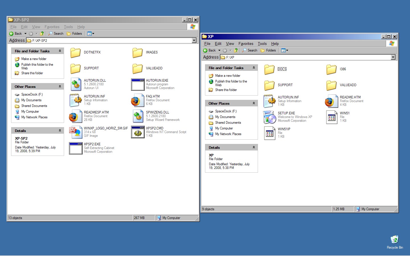

  10. Hello All, I've was directed here from another site. I'm attempting to create a restore cd by slipstreaming XP with Sp2, both are each on their respective cds. I've copied the files from each to folders on my HD. The process seem to require files from the XP cd, and the downloaded service pack files into their respective folders. PROBLEM: I need to integrate files from both folders of the XP CD and the SP2 CD. I've copied the files they are already there how do I merge them together. Using nLite seem to involve the downloaded form of the XP SP2 files, but my files are on the SP2 CD, and I don't see how to integrate. them. How am I going wrong! regards, Asamp
