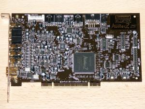

elny replied to elny's topic in Software Hangout
Hi Tarun Just to be sure. Here is attached photo of my sound card. It's SB0350 version of Audigy 2 ZS card. -

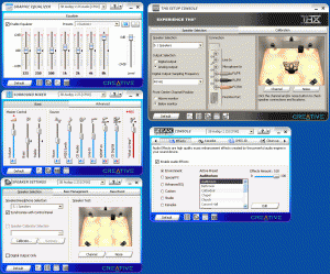

Hi. I am new on this forum. Have been searching around Internet for an answer to my problem for quite a while now but so far with no luck. I just need little help with my Creative Sound Blaster Audigy 2 ZS card and Windows XP Pro (32-bit) with Service Pack 3. I have the following specs system: Mobo: Abit IP35-E (Intel P35 chipset) motherboard (with latest BIOS) CPU: Core 2 Duo E6600 2.4 GHz MB L2-cache CPU with Arctic Cooling Freezer 7 Pro RAM: 2x 1GB Corsair DDR2-800 VGA: Sapphire Radeon X1900 GT 256 MB PCI-Express HDD1: WD Raptor 37 GB SATA (Windows XP Pro installed on it's C: partition) HDD2: Seagate Barracuda 7200.10 320 GB SATA2 CDD: Lite One SHM-165S6S SATA Sound card: Creative Sound Blaster Audigy 2 ZS PCI TV tuner: VisionPlus Twinhan DTV DVB-T PCI card Few months ago (right after SP3 came out) I deployed SP3 on to my system with nLite-d Windows XP Pro that previously had SP2 on it. All worked fine. But then I re-compiled a new nLite Windows XP Pro unattended setup CD with SP3 integrated. After installing Windows from this CD suddenly I started experiencing a problem with my sound card software applications. Problem: after installing Creative SB Audigy 2 ZS driver and its software applications such as Surround Mixer, Speaker Settings, Speaker Calibrator, EAX Console, etc. these applications (particularly Surrond Mixer, Graphics Equalizer, Speaker Settings, EAX Console, THX Console) do not work, they just won't start, won't load, won't appear in the screen. No error messages displayed. Although Speaker Calibrator starts and works as expected. I have tried over 10 times now integrating SP3 into different configurations of Windows XP Pro (with and without SP2 and without any SPs). But so far the problem is still in place. What I do after installing Windows XP Pro SP3: 1.Installing Intel Chipset Software Installation Utility (I tried infinst_autol_v.8.3.1.1011.exe and infinst_autol_v.9.0.0.1008.exe) 2.Reboot 3.Installing AMD/ATI Catalyst drivers (I tried original AMD/ATi Catalyst versions 8.3, 8.4, 8.6) 4.Reboot 5.Installing Creative SB Audigy 2 ZS driver (I tried SBAX_WBUP2_LB_2_09_0016.exe driver and then downloaded latest June/July 2008 driver from Creative website SBAX_PCDRV_LB_2_18_0001.exe but still am having problem). 6.Reboot 7.Installing Creative SB Audigy 2 ZS aplications 8.Attempt to start Surrond Mixer but it just won't start without any error messages! I have never had this problem before SP3 came out. And as I noted, if I deploy SP3 above installed and working Windows XP Pro with SP2 then I don't have problem. But installing Windows XP Pro with integrated SP3 leads to this problem always with no exception even once! I am really lost now. Can anyone help?
