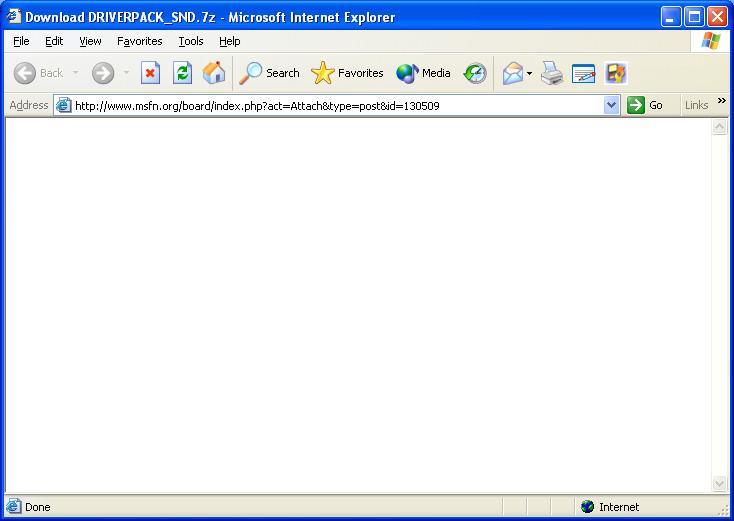

  5. Am I the only one getting a blank page when connecting to this site?
